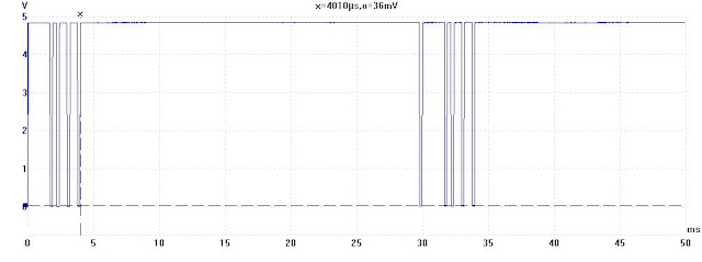

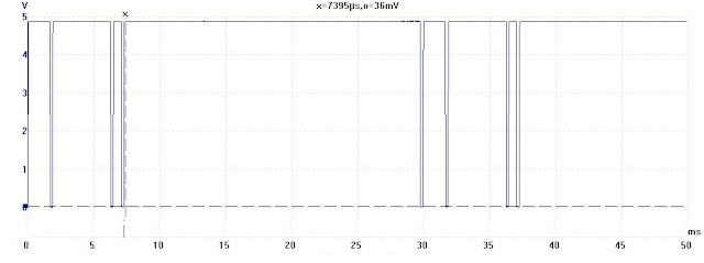

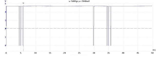

The vintage Nikko dictator Jr. car uses the c1059c integrated circuit on the board. To see if the board works well and you have an oscilloscope (and you know how to handle it), the signals that the car receives in pin 5 of the i.c. are:
BACKWARD (REVERSE)
FORWARD
FORWARD AND RIGHT
TURBO
